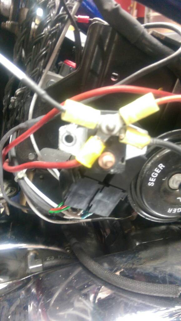

Typically the breaker would separate a circuit from the source in the event of a short etc.
Hence "bat" - "aux" although I think it would be better marked as "bat" - "load" but I digress.
So thats how they stamped their breakers.
Since they did not make them specifically for our BD setups we then have to do a work around for the charging system.
I think they should have explained the proper connection sequence in the BD manual though.
I would imagine if we had 10,000 of them made we could probably have them stamped "bat" - "vr" in the correct connection sequence...lol
Hey Curtis I found this little nugget tucked away in the manual tonight. Second paragraph Confirms our thinking. Along with your comment VR should have it's own internal protection from Battery
VR connected to BAT or gold post
battery connected to AUX, silver post.
LOL...Cool
So we do kind of know what were talking about then....LOL
Yep also confirms the shop the previous owner paid to install the PDM fucked it all up. They just read the breaker, BAT to battery...
Oh and I'm about to order everything else that blew out too. VR and tach ring, so order incoming in a few
Why nothing works anymore :(
