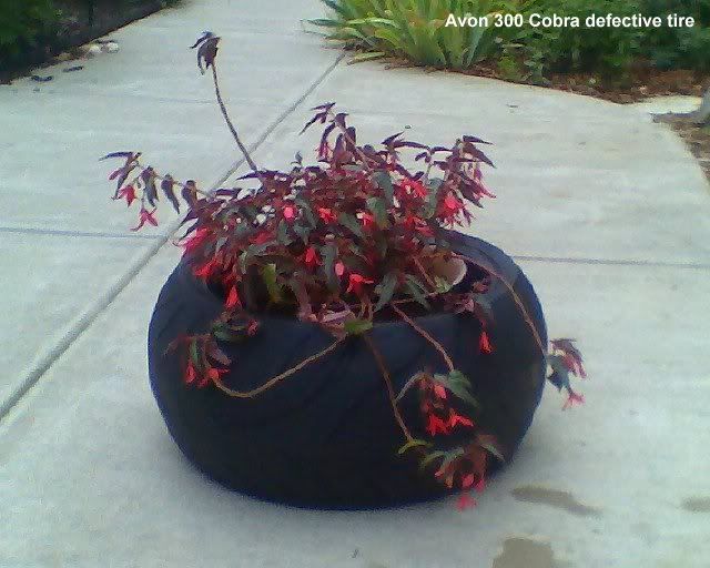

This is where the Avon Cobra 300 is mounted now.
Does it require much water:roll:

Bought 2 New Avon Menom's from Vince here on the forum since I was warned about the cracking & bubbling forum from reading It Here.
I still have an Avon Cobra 300mm that I am gonna use as a tire swing now.
