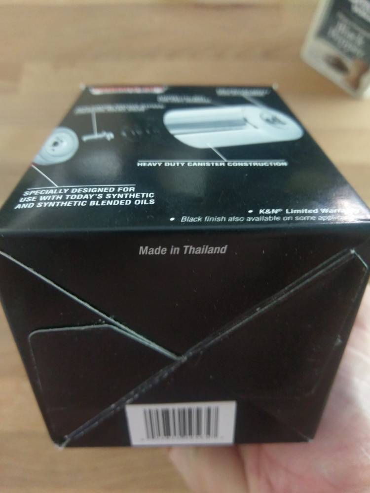

Note that on the washable filters a replacement paper filter is also available, so no washing needed.
Kit includes canister housing, mount plate, seals and cleanable element. Filter down to particles as small as 2.56 microns and has an intergral magnet placed in the element. Replacement stainless steel or paper elements are available separately.
