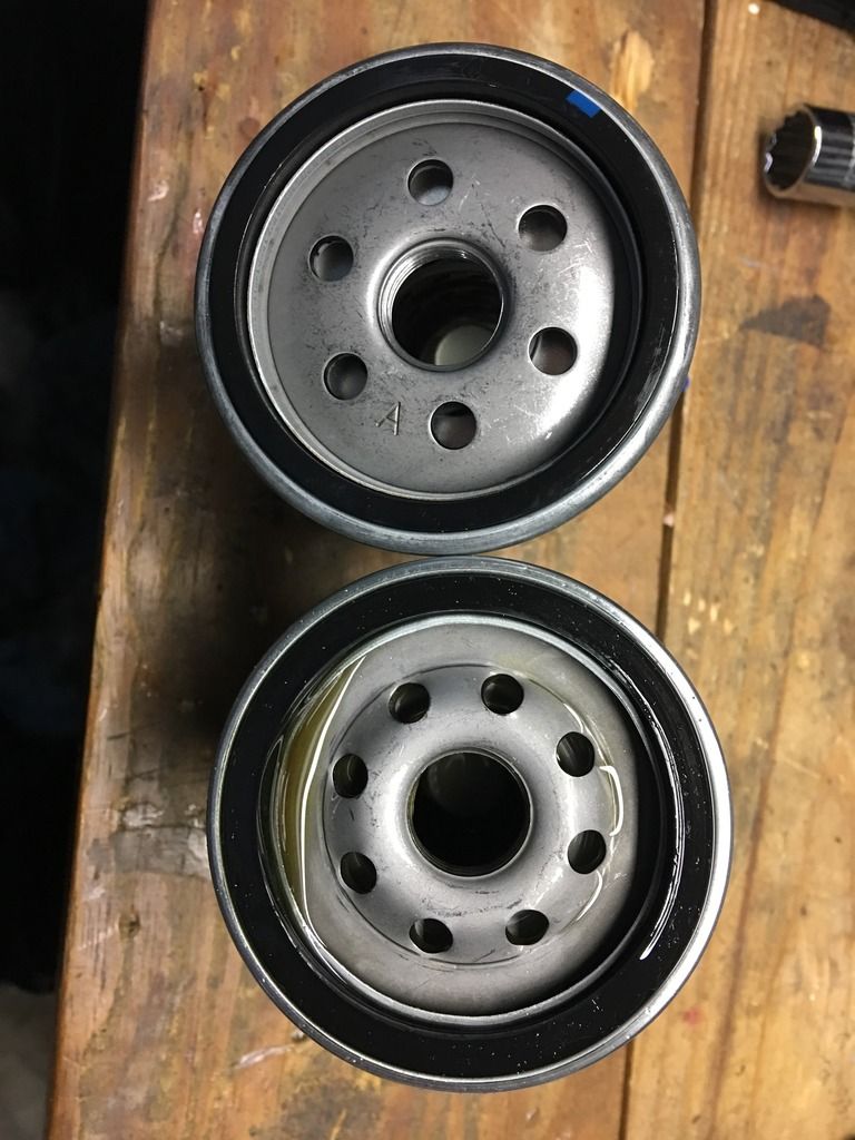

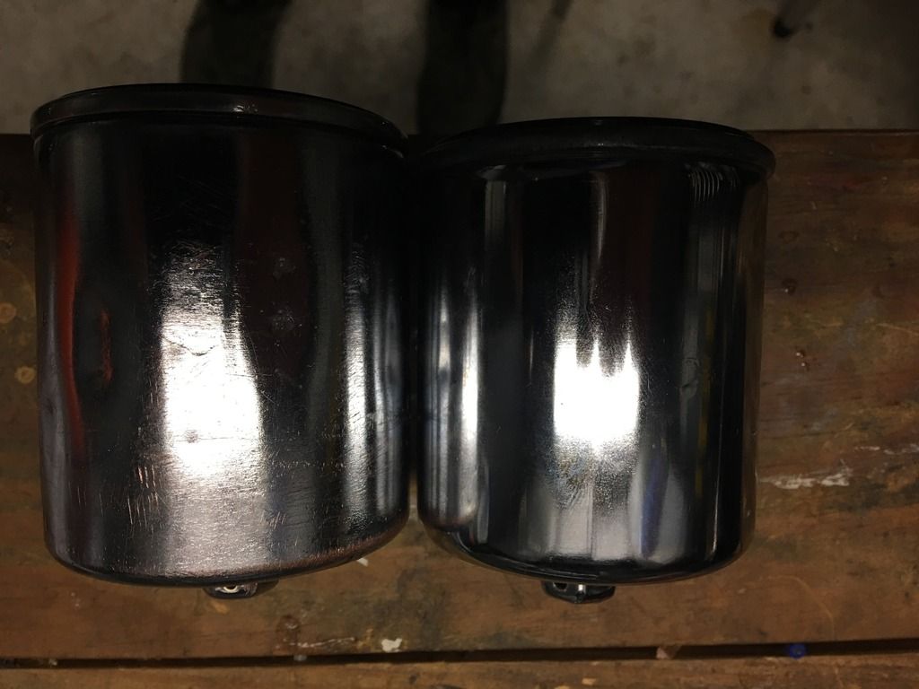

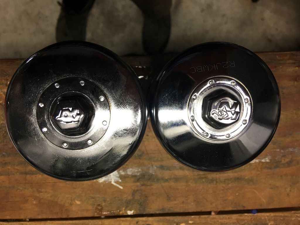

What the.....I decided to go ahead and replace my oil filter with a new one. Check out the pictures. The short one (on the right)is a new K&N unit that I purchased off of Amazon 2 days ago for $8.40. Compare it to the same model (K&N 170C) that I purchased back in 2016 from the same vendor. The new one has a detailed K&N logo, 6 drain holes and is shorter than the other one. It looks like I may have gotten a Cheap Chinese knock-off of a K&N filter back in 2016. Maybe this Chinese "copy" did cause my overfilled sump issue by not allowing oil to return to the oil tank fast enough?? I read that Amazon is full of Chinese Junk...

I think K&N filters used to be made in Korea, now in Thailand. There was a change in filters when they changed manufacturer.

Well, I do believe that was the issue as I've had similar things happen.
Also when you at the logo on the one -- its not right (center of nut)
Getting the wrong filter is also what motivated me to along with long term cost to convert to the K&P Engineering permanent oil filter.

Just saying a twin Cam 171c is longer than then the 170c.
Could have been put in the wrong box

Thanks for all the knowledge on this topic. Great read and very informative. So to be clear. K&N 170c filter is a 6 hole or 8 hole. I've always just relied on the fact that they were boxed correctly. Just changed oil about a week or two ago and never took notice to the number of holes. However I would like to know so when I buy new ones I can check before hand, until I buy a washable. Need to get the money first, by wife needs new car and daugther is getting married so temporarily I'm changing my name to Fundsalow.
