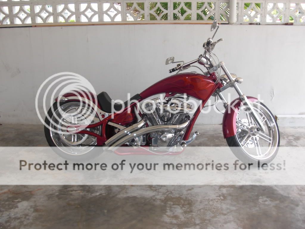

I just ordered Hooker Troublemaker Slach Cut for my 08 Mutt. My part number is 27406-3HKR, why is it different and do u think they will fit the MUTT.
Thanks
Nick
The part number is different because you have a 250mm rear tire and his pipes need to make the extra clearance to go around that massive 330mm rear tire. If your part number is for a 250mm rear tire with a right side drive, then I'm pretty sure it will fit.

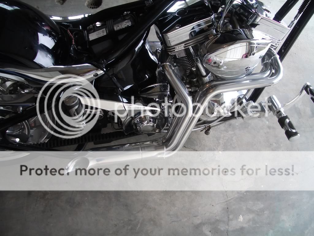

exhaust
These are Thunder Cycle Design 131's. The performance is a little off compared to the Vance and Hines reverse radius.

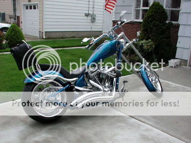

HOOKER FOURBIDDEN
Find someone who already runs that set up on their scoot first. I put them on my '06 K9 after waiting for over a year for Hooker to make them for RSD. The minute I got on it I wasn't too happy. First, they are wide from the frame. When you put your foot on the peg you notice it's close & hot. At a light, it's real hot on your leg which you'll also have to swing out about an extra 4" to clear them. They also are high to the stock air cleaner if you have it, like right up on the bottom of it. This isn't the greatest thing either. A little engineering & it could have been right but seems to me Hooker rushed to get RSD pipes out without the proper testing. Next on the agenda, their chrome sucks big time. Drove it in 35 degree weather when they were just installed & you would think I ordered them in Blue Chrome. I know over a little time they would blue, but 20 minutes in the cold? And my final complaint which I just noticed. The battery cover on the right side is feeling the heat. I can see & feel slight distortion in the cover from the heat. I fell in love with these pipes when they first came out & couldn't wait for the RSD version, MY BAD! The good is they are strong & LOUD.

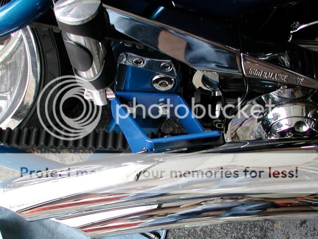

First 50
Felt it was time for a change from my Mean Mothers so picked up Chopper Daves old BR pipes.
I had the bracket powder coated and installed them today.....
