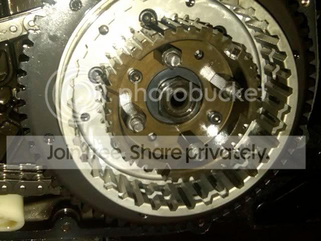

Well I think I found the culprit with my belt. Looks like the top bolt from the coil cover backed out and fell down behind the primary and got wedged in there. :bang:
That being said, I have followed the pdf that shovel posted above( thanks:up: ) but am not seeing how to get this final piece off. Can someone take a look at this pic and tell me how to get this thing off. I'm probably missing something simple but I'm out of ideas. Thanks
Sure, pull that clutch hub nut (in the center) and pull the assembly out. On the 05 and newer it's a 1 5/16" nut. Not sure if you 04 and older is the same.
