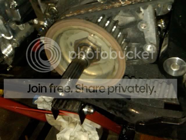

Not sure what you are cranking on but here is the torque spec for you.
Rear pulley bolts 60 ft lbs, blue loctite
I am trying to put the entire primary back on and the transmission pulley. The harley manual says 110 lbs and then back off to 30 lbs for the transmission pulley lock nut. I screwed it all up trying to lock this thing in place and get the 100 lbs.
Here is what I am trying to get the spec for first.
mcgroom
Transmission main / clutch hub shaft nut 80 ft-lbs - red loctite
Do you have access to an impact?
I have not done it but there are tools made to lock the pulley in place.
Some of the other guys are going to have to chime in on this one before you do it, but from what I just read, it looks like you can manually put the transmission into gear and this should look the hub so you can torque it down
