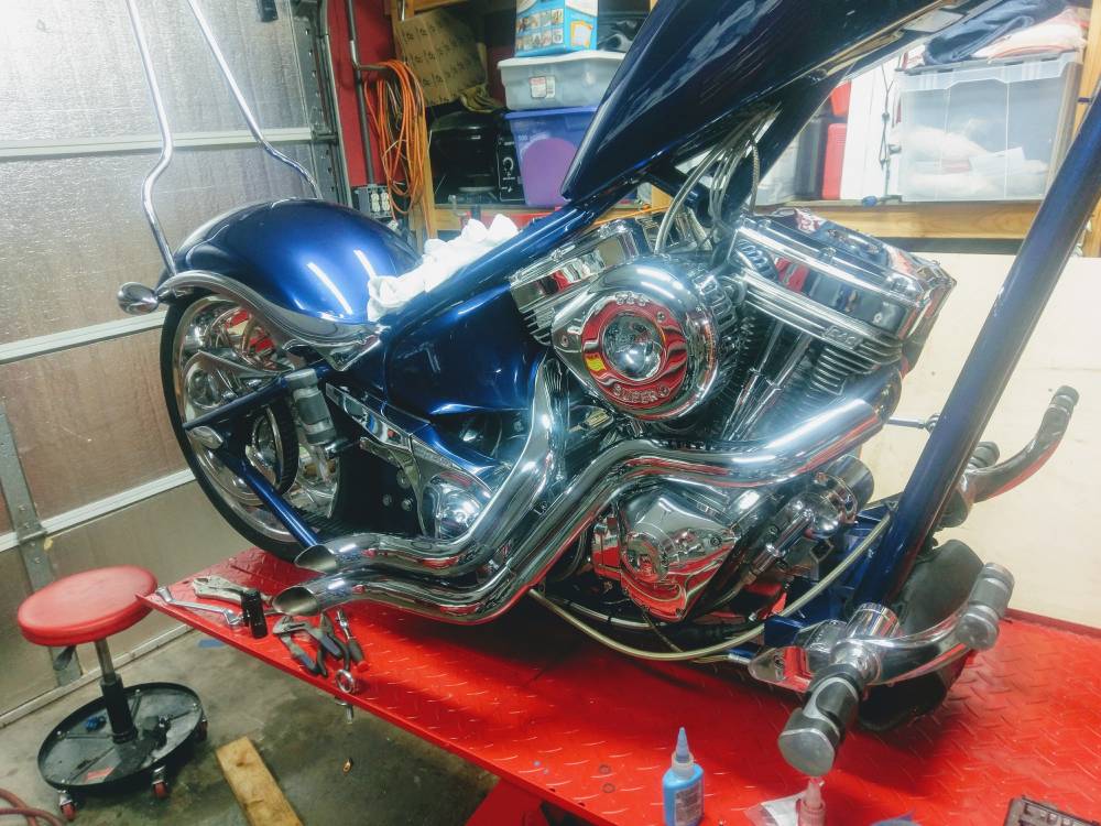

I did! Ruined it! This was before.Have you been polishing?...![]()
Yep that and the clutch cable will be removed and relubedDon't forget the air filter with all that sand flying around.
Visegrips? Shame on you..I did! Ruined it! This was before.
Well it was shiny...I did! Ruined it! This was before.
Think I used those with the welder to hold the nut and washer. That was when I was making the baffles.Visegrips? Shame on you..![]()
Makes sense, just seeing visegrips on a lift raises red flags for me..like the dudes at the local Harley shop..Think I used those with the welder to hold the nut and washer. That was when I was making the baffles.
