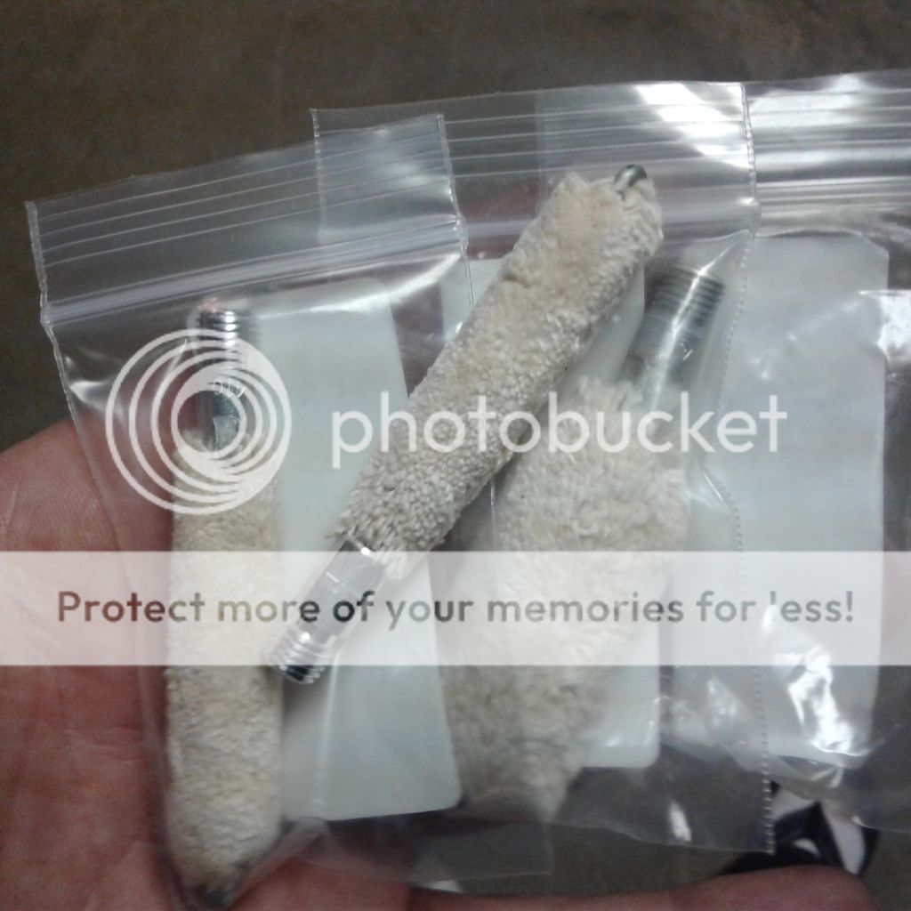

I just picked up these gun cleaning swabs, going to give them a try.View attachment 45629 I use Mothers Billet Polish. Love that stuff! My bike never sees water. I (Wash) it with Mothers Waterless & Wax spray. Works wonders. In case anyone asks, my K9 is not a garage queen. I ride it a lot. Any suggestions on how to polish a little further in between the fins?

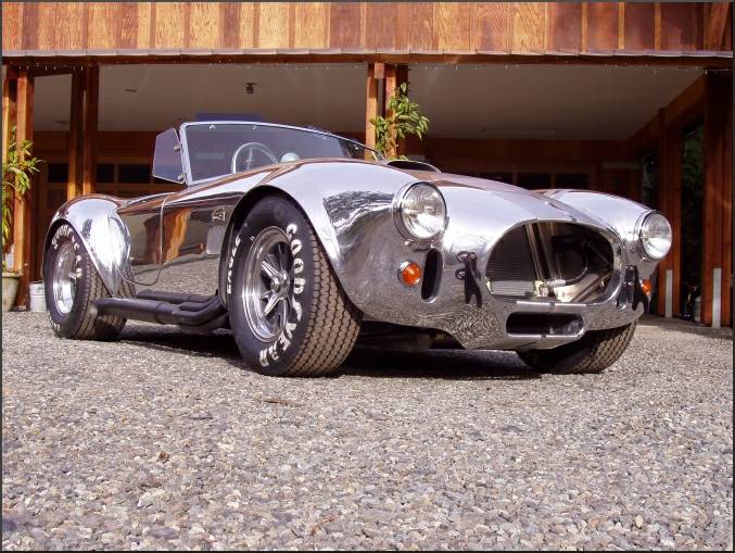

Raw Polished Aluminum Cobra

Roflmao My thoughts exactly!!!I'm a lot more impressed with Megan holding that sign up for 23:45 than I am the Bling Master. The next time you try buffing your billet aluminum, try it with just a clean buffing wheel, you'll be surprised

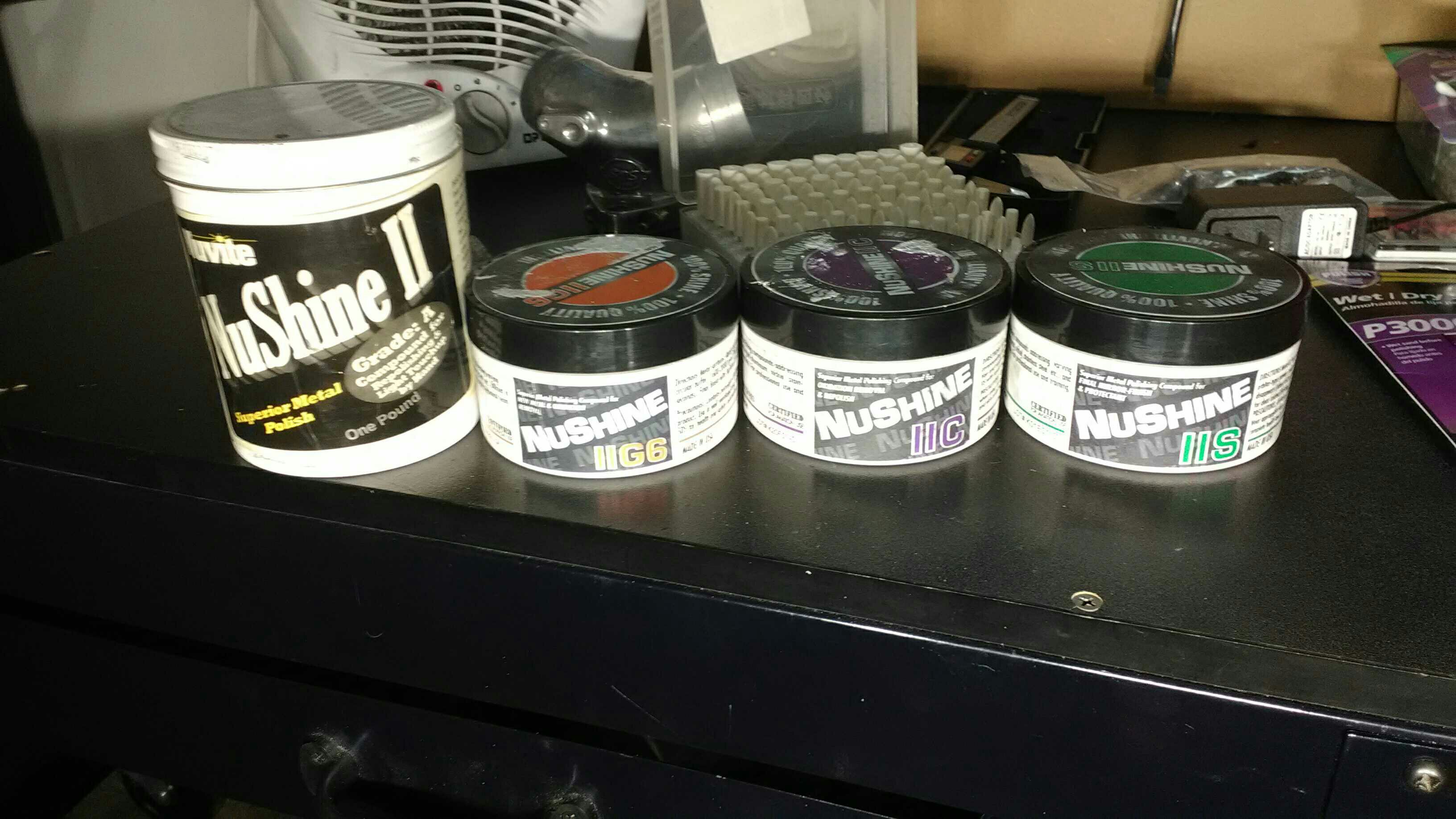

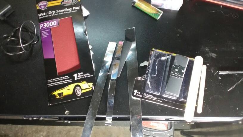

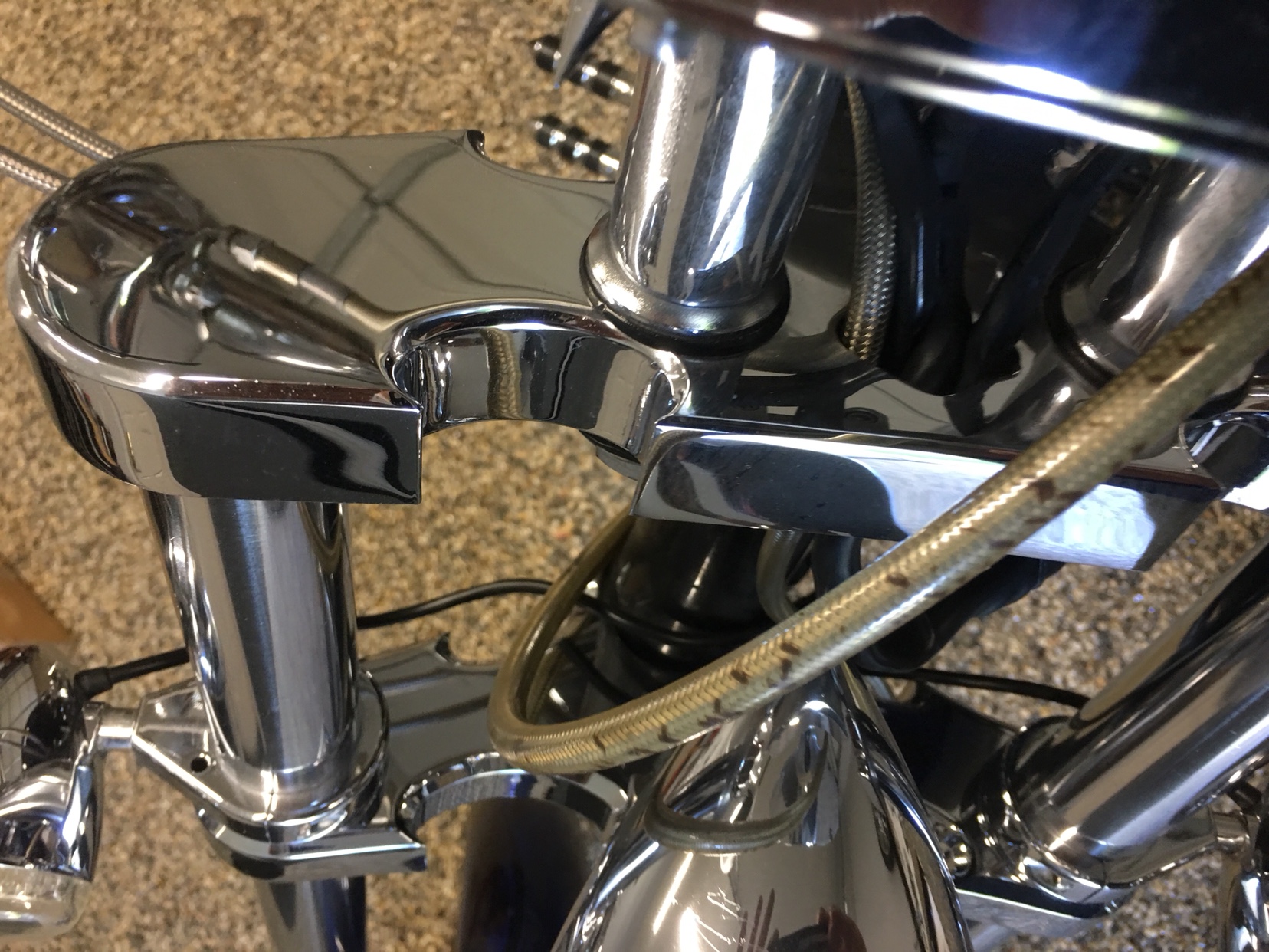

My first time polishing aluminum I took few lessons from father with the nushine aluminum polish. They use it on the airplanes at Boeing where he used to work. It's incredible. We started out with flanel and a tongue depressor or Popsicle sticks to get in between the fins of engine. When I bought my bike it was poorly kept clean so I decided to sand the entire engine starting low grit working up to 2000 and then finished with a 3000 thin sanding pad(which works better than paper)View attachment 52333

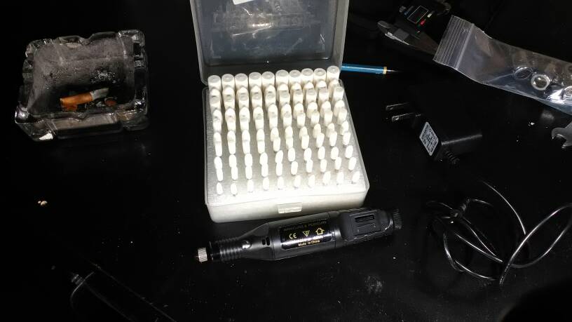

This will take a lot of the hand work outta polishing. Not to mention the time . I might have posted this before but couldnt find it. I use cotton baby diapers but some have started using flannels. Hope it helps
