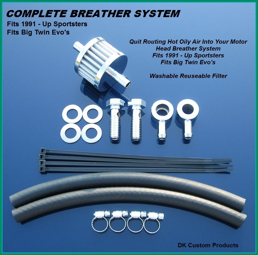

Looking good L A . What did you end up doing with the breathers? I am just about to mount my rebuilt carb and like you stated in an earlier post don't want any crap in the carb.
LA_Dog
Go Fast, Go Faster
my mech made some custom bolts that connect to banjo fittings. the bolts had a hole drilled in the center lenghtwise and then a horizontal port hole that feeds into the banjo fitting. these banjo fittings sit outside the carb bracket and the bolts are long enough to go through the bracket and the banjo fittings. at the banjo fitting we hooked up a braided line crossover from front breather to rear breather, then ran a braided line down from the rear breather to below bike. I'm sure you can buy this type of bolt setup on ebay though- search for Evo head breather bolts, banjo fittings etc.
You want something like this but with the bolts long enough to go through the carb mount bracket as well as the included banjo bolts. here is the ebay search string for related parts: http://www.ebay.com/sch/i.html?_trk...ey+evo+head+breather+bolts&_sacat=0&_from=R40
