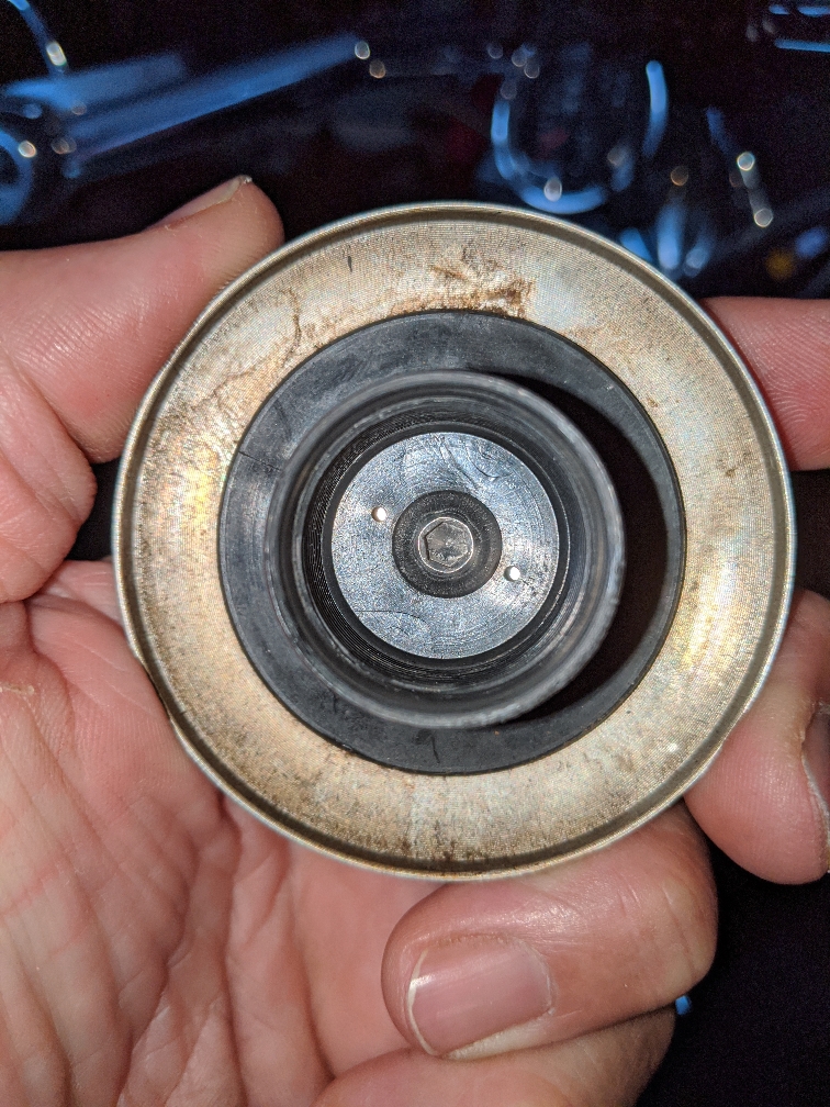

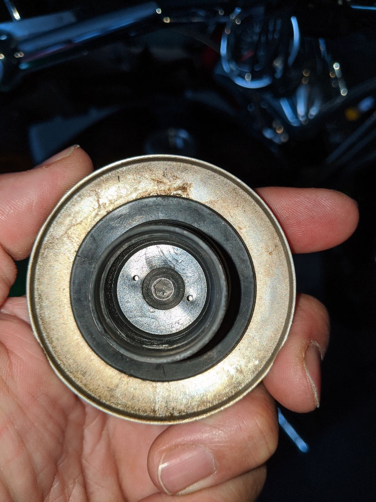

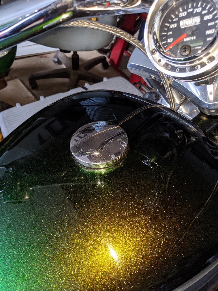

This is what my gas cap looks like on the bike, and underneath the cap pics. Didn't really see anything white is this a new cap or an old capThe little white piece has been a problem in the past. Thats why the new ones don't come with it.
Can you blow through it?This is what my gas cap looks like on the bike, and underneath the cap pics. Didn't really see anything white is this a new cap or an old cap

Yes a little air comes out of one of the holes on the side just seems to be only one hole though that it comes out.Can you blow through it?
